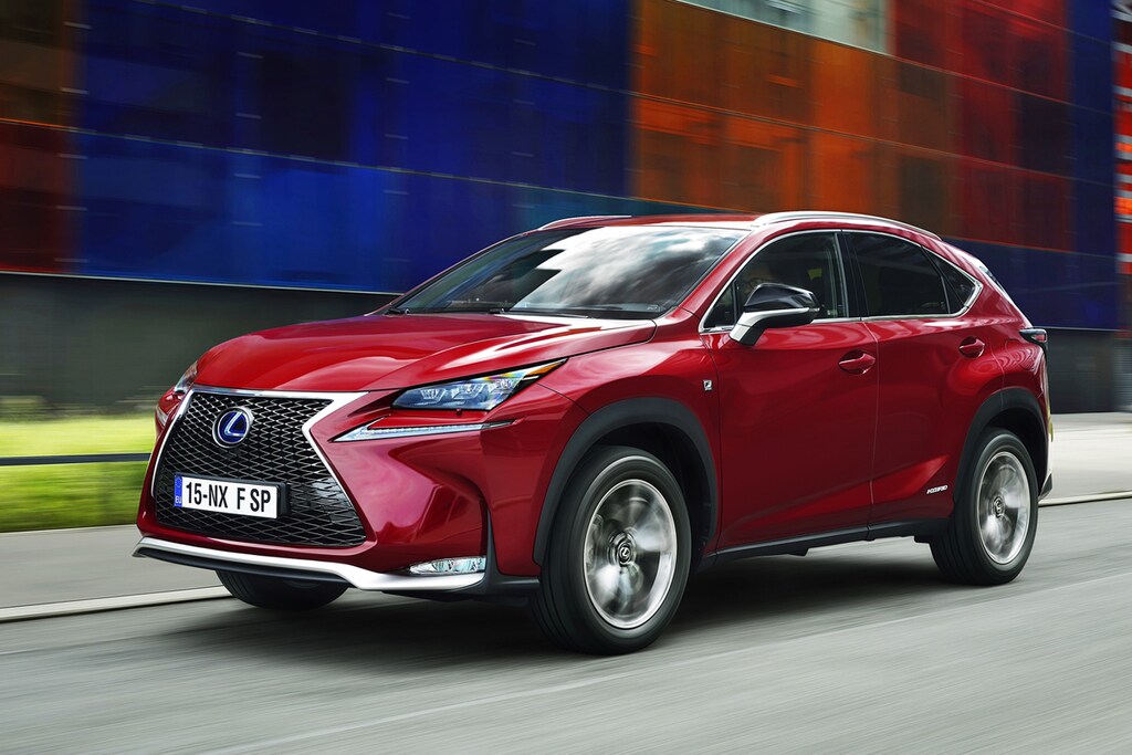

      • Foto's Paris motor show
        bron: www.inautonews.com/paris-motor-show-live-lexus-nx-300
