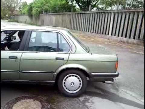

                                    • + YouTube Video
                                      Nog 6 cilinder fun
